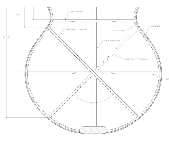

Graig I have been using this pattern on my SJ backs for a while now I am in no way an expert on the physics of the backs response due to this pattern but my mid tones and highs seem to be brighter and the guitars are louder than with conventional ladder bracing.
There is an other lateral brace in the upper bout not shown in the picture.
Another benifit I get from this pattern is it supports the dome shape in the lower bout better. and I can brace a bit lighter.MichaelP39003.3831944444

Michael, how do you do the xbrace and the lower lateral brace? Are they all notched to fit all together or just the X and the lateral brace is butted up to the X brace with a cap over everything?
Sorry to point this out, but if you measure all the braces on the back, you'll find you have a lot more bracing, and much less open back area, than on a conventionally braced back.
Not saying one is better than the other, but I am merely pointing out that being lighter is not a benefit of the X brace system for backs, as it is indeed not so.

I notch the x portionx butt the laderial struts and cap all with a disc shaped cap thentrim to the braces and shape with a finger plane.
PostPosted: Fri Oct 13, 2006 8:06 am
I did not mead or say that I had less bracing area. I ment I can brace with thinner shorter profiles. My weight is actually up a little. but not as much as you may think.

Thanks for your plan Michael. A very cool looking brace set up. What dimensions are those (star) braces ,and what is your back thickness. I can clearly see why this bracing type would have the guitar project more , as it would lesson the back's movement . Have you noticed any less bass reponse with this firmer back ?
